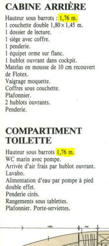

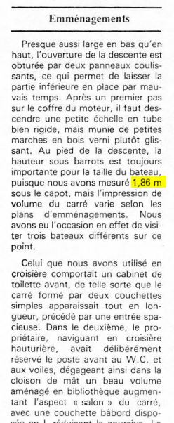

My particular questions is this; what is the headroom of the Ovni 28? I am 1.83m tall, and need to be able to stand in the galley and near the companionway. I would like to be able to stand in the head also, but that's not essential.
I have found a few conflicting accounts online, so I though I would ask if an owner could settle the question with a tape measure.
Here are two documents which give different measurements:
Any help or advice is greatly appreciated

Hello and welcome,
From what can be read (the Ovni 28 is a very old boat with few left) you will be able to stand only close to the companionway under the hatch.
Headroom in the rear cabin and head is close (1m76) but below your height. Some folks have made some changes e.g. installing a door in the companionway, but that doesn't change the headroom in the cabins or toilets.
Best regards, Kev

Thanks Kev,
Sounds like the 10cm difference is the height of the hatch above the cabin ceiling. So I wouldn't be able to stand straight in the galley. That's a disappointment, and ultimately a deal breaker for me. A shame because this little boat ticks almost everything else on my wish-list.
Tough to find that headroom in a smaller boat, and I might be forced to go a bit larger into the 35' range. Ah well.
